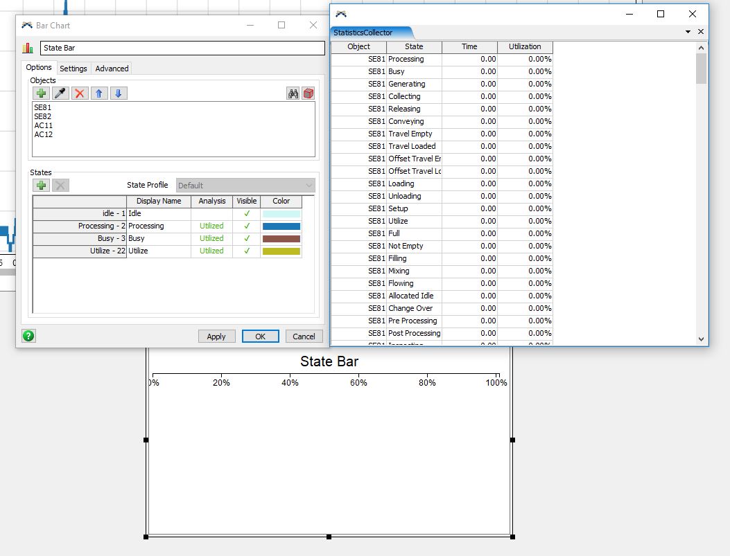

Hello, I'm trying to add State Bar graph to my dashboard to see the utilization of some location objects (Registration desks) but the graph shows no state and I noticed that when I click on one of these objects the QuickProperties shows no state.
The persons are sent to those counters by an Instanced Task Executer Process Flow.

States for people module objects are still under construction. We're planning to add separate state profiles to track people module stats, so feel free to manage the state of the locations yourself on the default state profile.

No matter which states I add to the Default they always show 0%. I didn't try all 50 states but I tried busy, processing, utilized. In fact when I View Table on the Advanced Tab, everything is 0%. And I know that 271 people went through one of the objects I selected.

Yes, you'd have to manage the state yourself by using code to set the state of the object.

Thanks. I just did that (Trigger en Entry, setstate) and it works !!!
