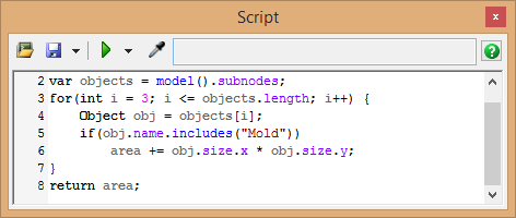

You can just copy the script into the Script Window.
Open the script window by pressing the button in the toolbar.
Then paste the script and click the green Execute button. The return value is displayed in the results field at the top of the script window.
My script isn't a very robust one. You seem to have a non Object node in your model tree.
If you just want to skip anything that isn't an object use this script:
double area = 0; var objects = model().subnodes; for(int i = 3; i <= objects.length; i++) { if(objects[i].is(Object)) { Object obj = objects[i]; area += obj.size.x * obj.size.y; } } return area;
