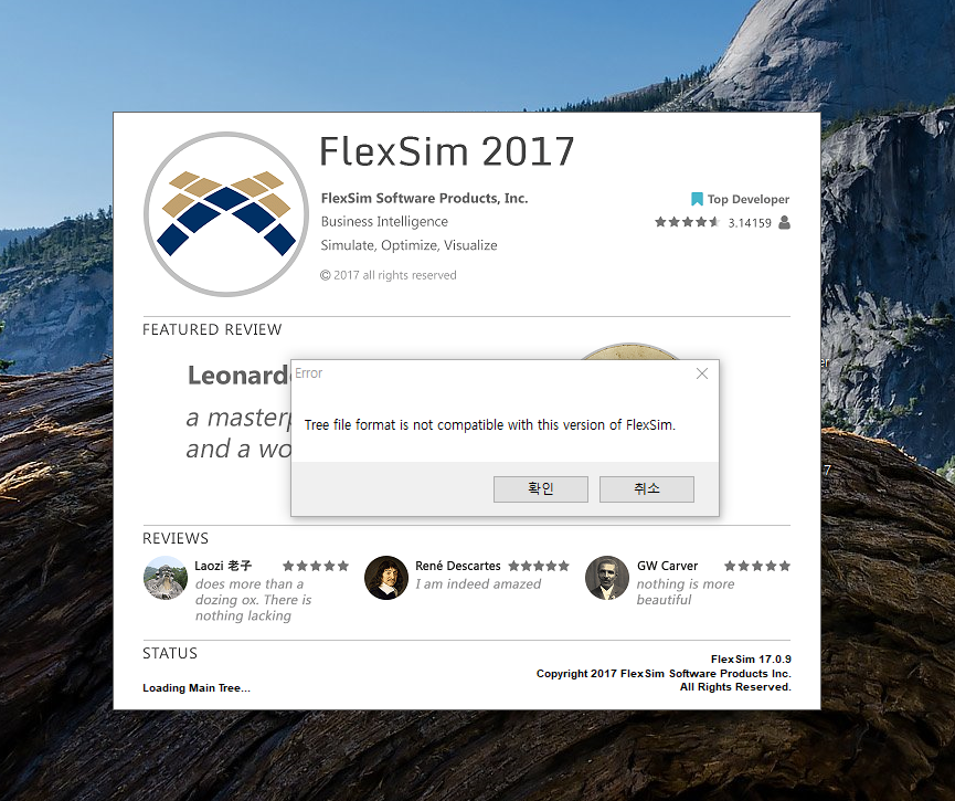

On
What's the problem in it?
I am using it with 17.2.1 version.
On

The attached error message is appeared when I run LTS without any model.
I run only LTS version.
The error happens when run only 17.0.9 without any model.
Hi @david.seo,
Perhaps your prefs.t file is corrupted, or is being shared between versions of FlexSim when it shouldn't.
While FlexSim is closed, try renaming your prefs.t file to _prefs.t, then start FlexSim 17.0.9. If it works, then it must have been a problem with that file.
Instructions for finding your prefs.t file can be found in this article.
