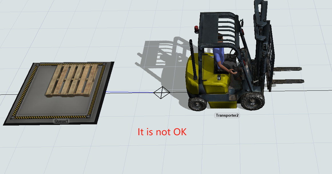

How do I control the orientation of the taskactuator rotation without modifying the AGV path? For example, if I want the forklift to move an item, the fork Angle of the forklift is toward the item.
I tested this method. It doesn't work on AGVnetwork。
If you set the "Switch to Forward" threshold lower than its reverse counterpart, the task executer will prefer to travel forward when rotating to a new direction.
Another possibility is to react to the On AGV Build Travel Path event and set the "isAGVTravelOrientedForward" property on a given travel path to enforce the travel direction. This is a "hacky" solution though and not officially supported. So you might run into other issues with this method.
