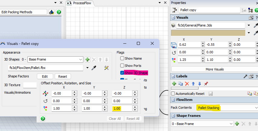

You are not stacking the boxes on the pallet but other pallets (with the boxes on them). The stacking logic thus uses the height of those pallets for the placement.
You can use the "Pallet Stacking" stacking method (set in the FlowItemBin) so that the pallets are automatically resized to include the boxes within their bounding volume. For that to work the plane must have an actual height (something like 1mm) and the Shape Factors all need to be set to 1.
You could then also hide these 'layers' by deactivating the "Show 3D Object" option.

Thanks a lot for your help! That solution worked exactly as I needed. I really appreciate it!
