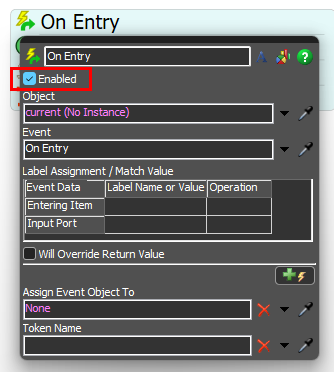

How to change the Enabled property of Event-Triggered Source activity using flexscript?
Thanks in advance.
Thanks in advance.
setvarnum(activity, "enabled", 1 / 0);
// optional, to refresh the activity's icon without having to re-open the process flow function_s(activity, "updateIcon");
For this particular option you can find this code when you link the source to a model parameter and choose the "Enable or Disable" option.
In general, most properties are stored in the variables attribute node of objects, whose value gets changed with the command above.
For objects in the 3d model you can check the available columns in a property table to find what can be changed with the "object.setProperty()" method.
