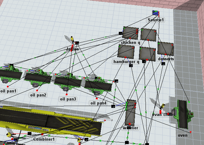

For example, when my warmer reaches max content, how to let oil pan stop process, I've tried lots of method, but still can not do it.

Hi @james!
To change that setting in your 3D model, I would first change the max content of your warmer to the value you want, say 25 for this example:
Next ctrl + select all your oil pan processors (so you don't have to update them individually) and add 2 triggers, one On Entry and one On Exit.
Next choose the values by going to Control -> Close and Open Ports
and for the action and conditions choose the values below with the condition below for the On Entry trigger
current.outObjects[1].subnodes.length >= 25
Do the same for the On Exit but change the action to openinput and the condition to be
current.outObjects[1].subnodes.length < 25
I think that will fix the issue but comment back if you have any questions!
