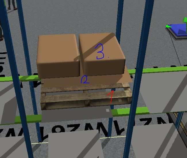

Hello users, I am building model of ASRS, but struggle with combining items (pallets, separators and boxes that arrive later)
1) asrs (palletizer) must distribute PALLETS on pallet positions (A1,W111,W151,etc.)
mix_autosave.fsm,
2) asrs (palletizer) must distribute SEPARATORS on pallet as a first layer on each positions (A1,W111,W151,etc.),
3) - this part works - and then boxes arriving from conveyor (IT STARTS TO ARRIVE IN FLEXSIM TIME 1204380), and each pallet should be loaded
4) when the pallet station batches the required number of boxes (W111 = 4 boxes, A1 = 4 boxes, etc.) palletizer should move whole pallet + all boxes in once, to the Output.
Please if you can give me a hint, how can I place a pallet always for the new batch of boxes and on top of this place separator as a first layer?
