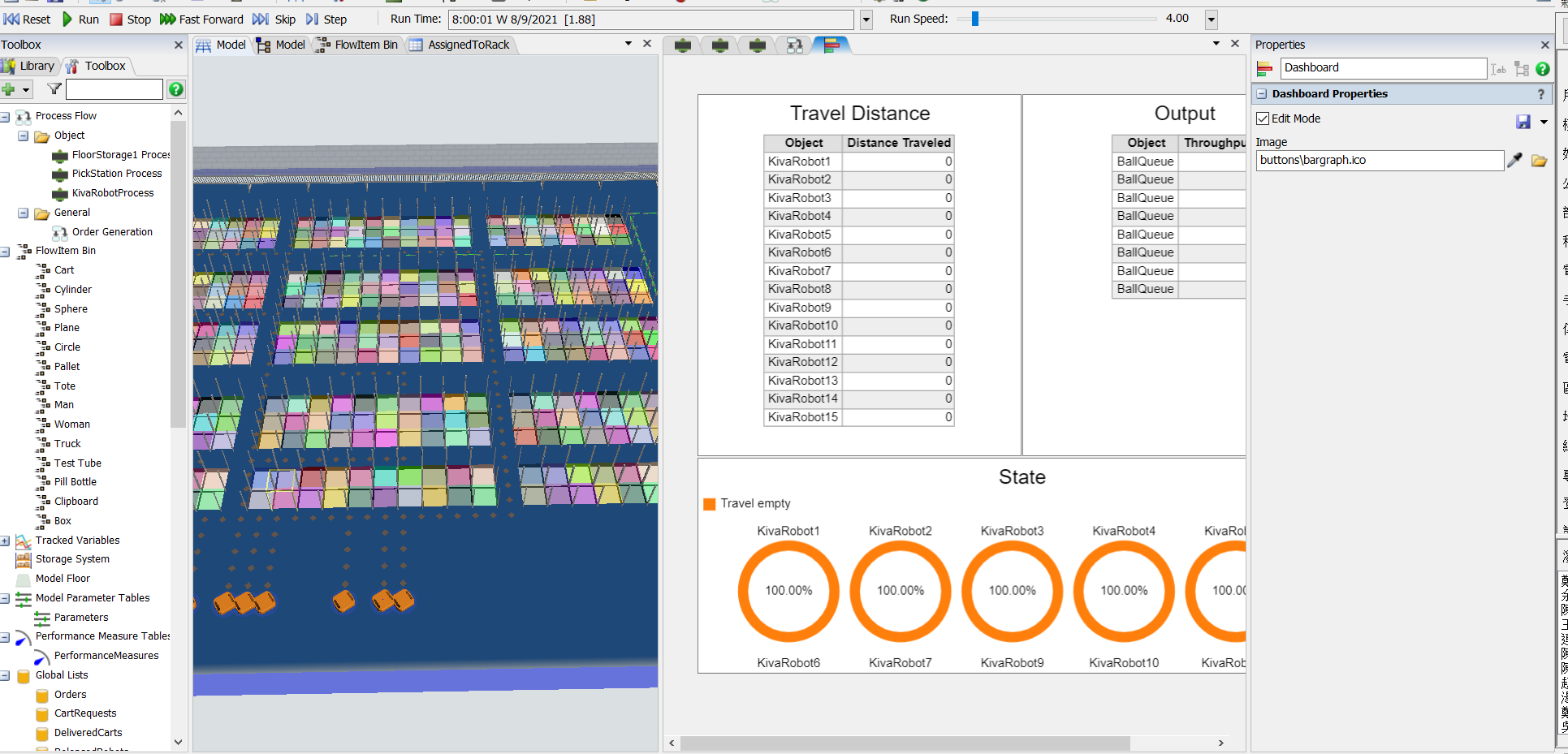

How to sum of multiple AGVs distance in dashboard?
I would like to sum of AGVs travel distance in the dashboard(kivaRobot), I use the Table Chart to caculate, but I can't find the distance column.
Is there anything smart way to set?
.AGVs Picking.fsm
Asking further, if there is a way to add up total distances. Is it possible to calculate the average utilization rate of multiple AGVs?

The quickest method, if the data doesn't have to show in the dashboard, is to use a performance measure. Sample the travel distance table from the dashboard and choose to calculate the sum.
To get the value to show in the dashboard, install the components of the table chart and use a calculated table to get the sum, then display that on the dashboad in a table chart.

Kevin-Hsiang avatar image Kevin-Hsiang commented ·
I have successfully used this method, thank you for your help!
