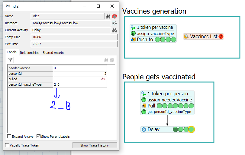

I took your advice as to looking at using the List function rather than the Batch function. In the example model you provided, you showed a way to create a custom label, however it does not seem to pull any of the text labels (only the numeric values). When I tried to apply this to my models I kept receiving errors. As you can see below in the screen shot, when I run your model the vaccine Type is not carrying into the new label. the 2_0 should read 2_B. Is there a way to apply this concept to a string of text as compared to simply integers? Thank yo.
Roi Sánchez avatar image Roi Sánchez Ely K2 commented ·
If you want to compose a string made of strings you just need to use the "+" command:
string myFirstString = "Hello";
string mySecondString = "World";
strint finalString = myFirstString+mySecondString;
return finalString; //HelloWorld
