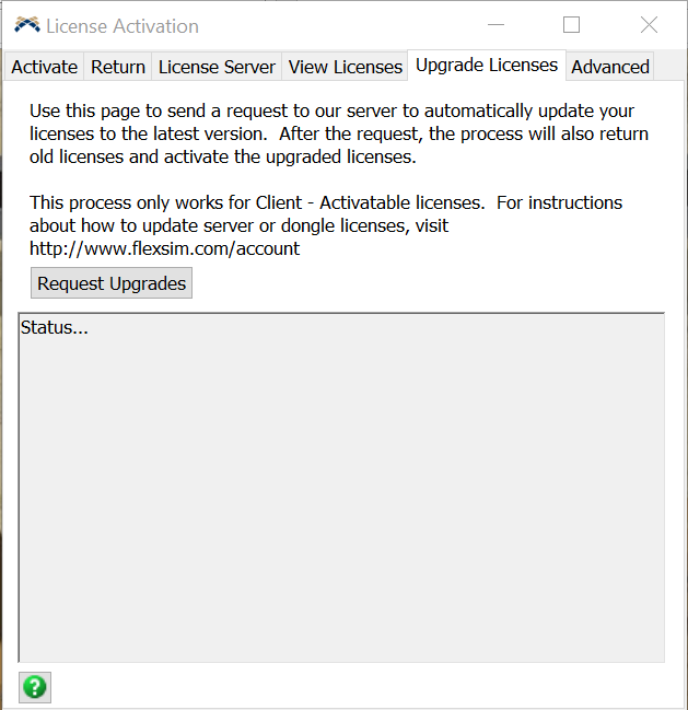

andrew S avatar image andrew S commented ·
flexsim-error.pdf
loaded vers 18, and now I'm getting a model size limit error. wahts the issue?
thanks
Andrew
flexsim-error.pdf (170.5 KiB)
Matt Long avatar image Matt Long andrew S commented ·
Looks like you don't currently have a license for 2018. If your maintenance is up to date then all you need to do is upgrade your license. This can be done by opening the License Activation window in the Help menu of FlexSim. Click on the Upgrade Licenses tab and click the Request Upgrades button.
Instructions for other upgrade scenarios are found within your FlexSim Account.
If your maintenance is expired then you'll need to contact your local FlexSim distributor in order to renew your maintenance.
