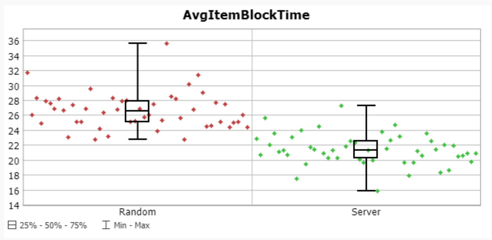

After training for 500k time-steps, the agent learns to choose jobs moderately well. If you run the inference script, you can use the experimenter to compare a random policy to a trained agent:
reinforcement learning
