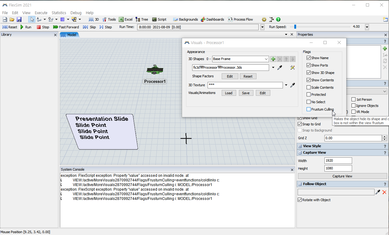

David Seo avatar image David Seo commented ·
I found an error(?) in Frustum Culling when uncheck.
And I want to know what's the Frustum Culling.
Phil BoBo avatar image Phil BoBo ♦♦ David Seo commented ·
Thanks for this bug report. I've added a case to the dev list for the exception and to document the Frustum Culling checkbox.
Frustum Culling can be used to not draw an object's contents if that object is not being drawn by the view. For example, if you check that box on a Visual Tool, then the contents of that Visual Tool will not be drawn if the Visual Tool's yellow box is not visible in the 3D view.
If you organize your model into containers, you can use frustum culling to improve the framerate of the 3D view when those containers are not visible by entirely skipping the draw of the objects in those containers.
Matthew Gillespie avatar image Matthew Gillespie ♦♦ David Seo commented ·
@David Seo This is fixed in 21.2.1.
