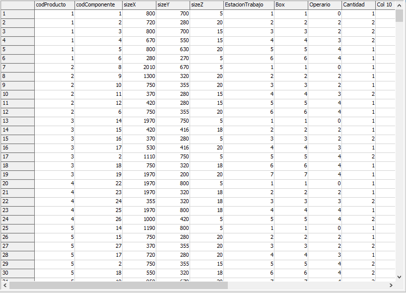

I have this problem if someone could help me. I'm going to try to explain you with more details and I will try to write a good post, in a case someone in future will need. I have two tables:
First table: ListadoOF_Lectura
Second table:componentes.png
In the first table there is a column called codProducto, in the second table there are two column:the first called "codProducto" and the second called "codComponente".In the second table for each product there is a list of component. What i want to do is:
1 I want to compare each product of the list with the others product of the list for finding how many component in common each product has with others.

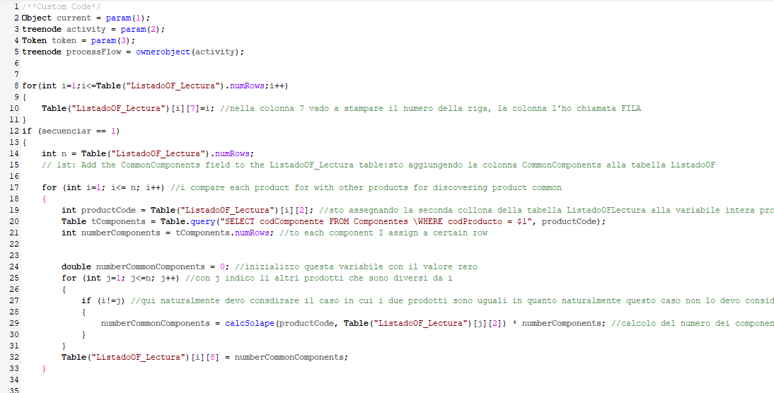

example: Prod1=(1,2,3); Prod2=(2,3,4);Prod3=(1,2,3). The Prod1 has 4 component in common.I want to obtain the total number. I want that the total number is showed in the table ListadoOF_Lectura in the last column. I will show you the code that i have, I'm a newbie in coding, so, any advice is good for me. This is the code:

In the code I have used the function Table.query for exctracting data from the table, but I m not sure if is correct.

Thank you, I would like to try to do it on Flexsim, I have attached an example but I'm not sure if the code is correct, I have used the table queries.

Hello @tanner.p, I have tryed to write a code using a table query but I don't know which kind of mistake i did it. I have used the example that you sent me some weeks ago.
Francesco

Thanks for clarifying that you wanted the sum of the components in common and not the actually component numbers. I wrote a script that will do this in the attached model, but make sure you clear the output table (Global Table 3) before you run the script. I wasn't sure how to add the logic to separate each count by product number, but I'm sure you could get that worked out. You can use this as an example to hopefully achieve what you need.
francesco-help.fsm
francesco-help.fsm (24.2 KiB)
