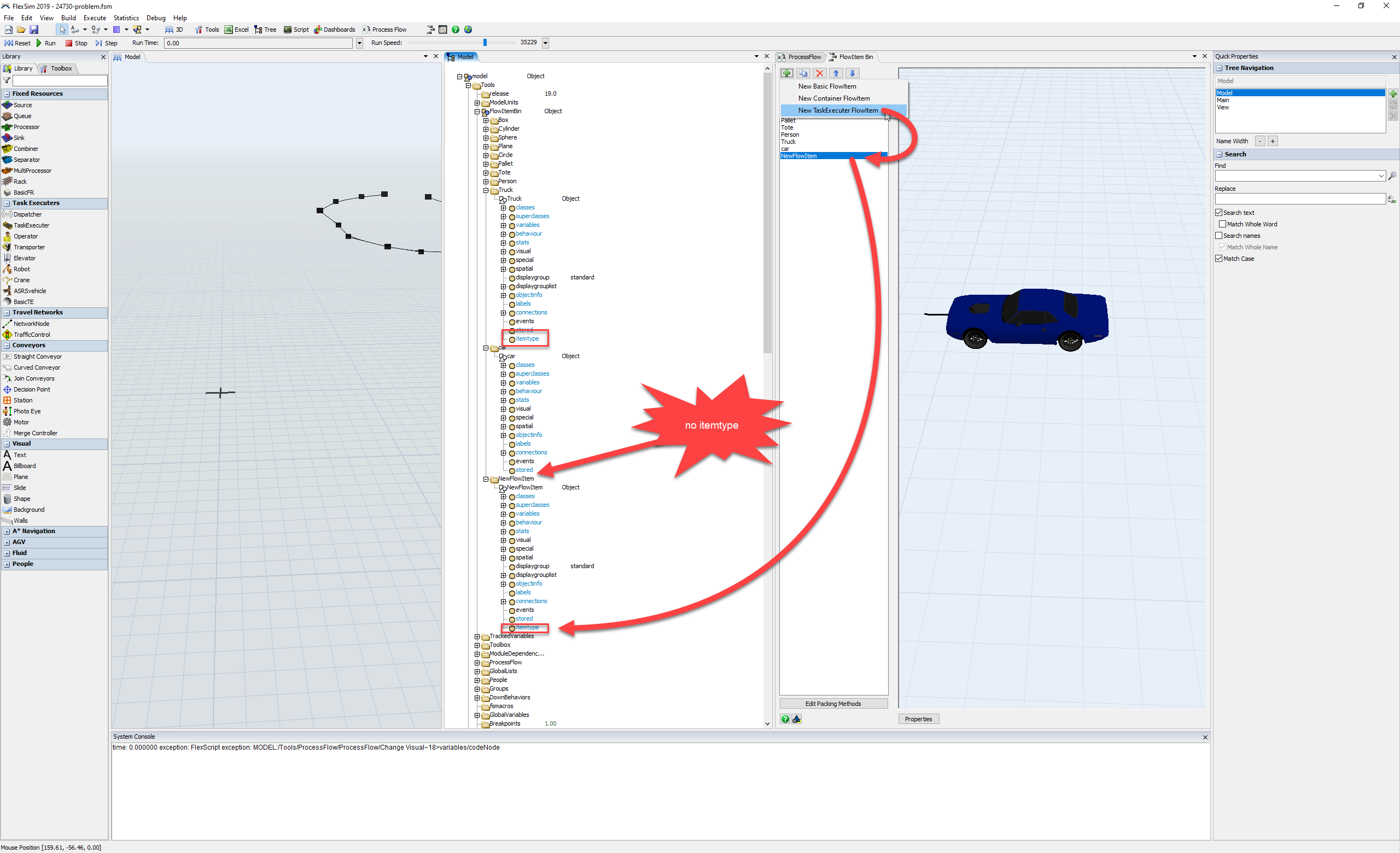

When you add a flowitem to the flowitem bin using the New TaskExecuter FlowItem button, it adds an itemtype attribute to the flowitem. Your 'car' object in the flowitem bin does not have this attribute, so it isn't being treated as a flowitem and deleted on reset.
I don't know how you added that flowitem object, but it needs an itemtype if you want it to work properly.
