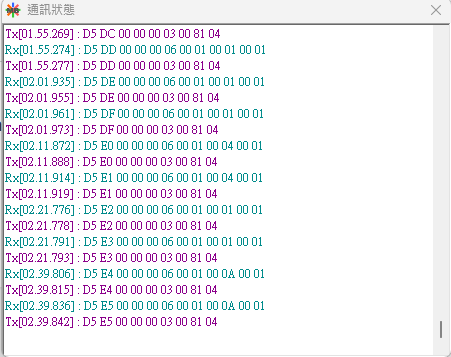

I have tried to connect it in series, but it didn't work. My current idea is that I assign tasks based on the status of my PLC. If the read Register = 0, the destination tag will be given.
If Register = 1 he will go to another one, but overall it is very unsuccessful. How should I proceed?1744700881151.pngplc.fsm1744700896486.png
What I want to ask is that I think I have completed the communication, but I don't understand why it keeps reading the coil instead of the register! In addition, there should be no big problem with my pf setting?? Except for the big problem of reading the plc signal
plc.fsm (95.2 KiB)
mark zhen avatar image mark zhen mark zhen commented ·
I have found a new problem. When I use the emulation tool to create variables, I can request my PLC normally. But when I use the pf tool to create variables and request, I cannot read them smoothly (it will become a coil reading). I would like to ask if there is something wrong with my creation method. plc.fsm
