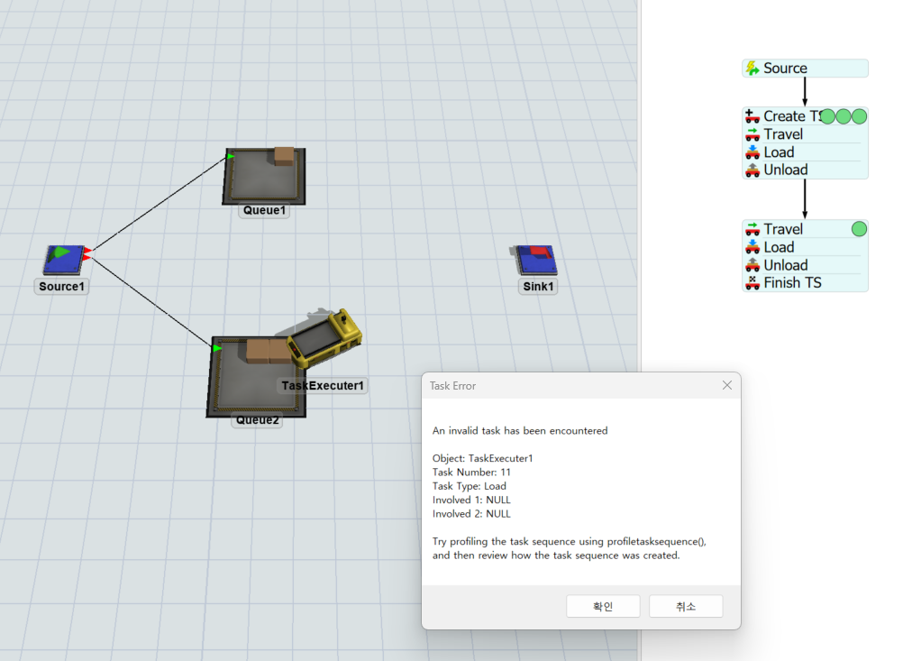

Hello.
I'm a FlexSim beginner.
I'm posting a question because I have trouble with modeling the AVG travel path.
For example, AGV is going to Queue 1 (Load) -> Sink (Unload) -> Queue2 (Load) -> Sink (Unload) as shown in the following image.
Error occurs in Load in Queue2.
I understand why the error occurs. I understand that it's because the object has been sinked earlier, but I don't know how to solve it.
FlexSim 25.0.1
load
Felix Möhlmann answered
I would make both queues push the items to a list, but to different partitions. In the Process Flow a token can then pull an item from Queue1's partition and move it, then from Queue2's partition and so on.
