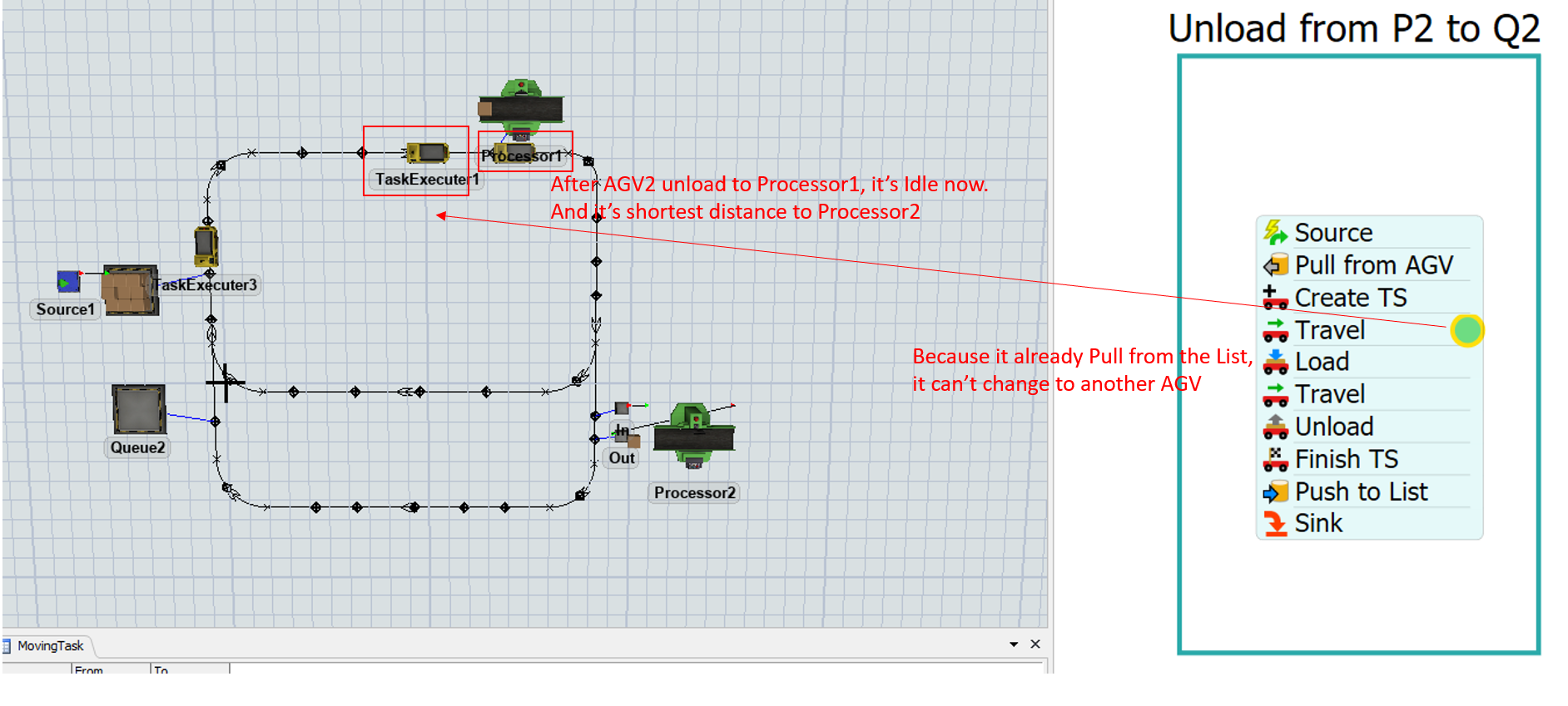

According the AGV's distance everytime to let another agv pick the item.
Hello FlexSim Community!
I’m trying to implement a function that allows an AGV to preempt another AGV’s task of picking up an item if it is closer to Processor2. However, once the task has already been pulled from the list, it seems the AGV cannot be changed.
Is there any method to implement this preemption functionality based on this modeling logic, or is there an alternative modeling logic that can achieve this?
