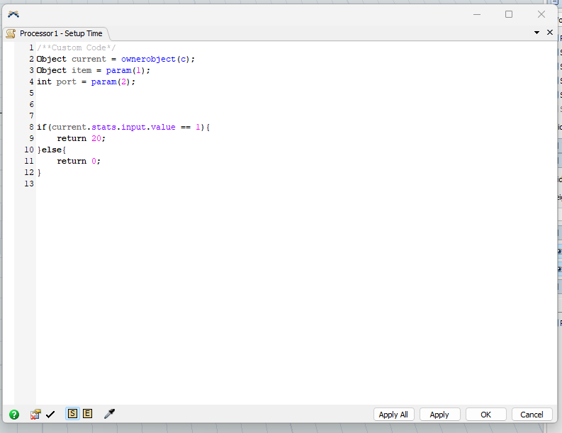

Hi @SEKAI, I hope you are saying that for the first product setup time should be 20 min and for other product setup time should be 0.
If this case - then refer the image attached. You can write code on setup time of Machine.
