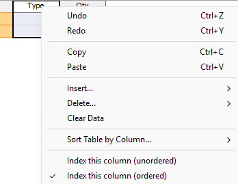

Felix Möhlmann answered David Chan commented
Is the column indexed?
· 2
David Chan avatar image David Chan commented ·
@Felix Möhlmann Thanks. I did not.
Can I use FlexScript to index the column?
David
Felix Möhlmann avatar image Felix Möhlmann David Chan commented ·
Yes, with Table.addIndex().
