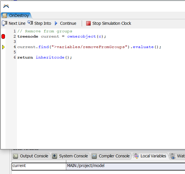

Hello,
how can one get the current object being destroyed during OnDestroy? My expectation is that line 2 below would return the object being destroyed, but it returns the model as the owner of this flow.
Thank you.

The question asks for the reference "during", not afterwards.
In fact, I discovered that in the case of OnDestroy, "c" represents the object being destroyed, instead of the "OnDestroy" script as in other commands.

Gui, I think all of the eventfunction calls pass the object in as 'c' unlike many FlexScript nodes where c is the node containing the flexscript.
