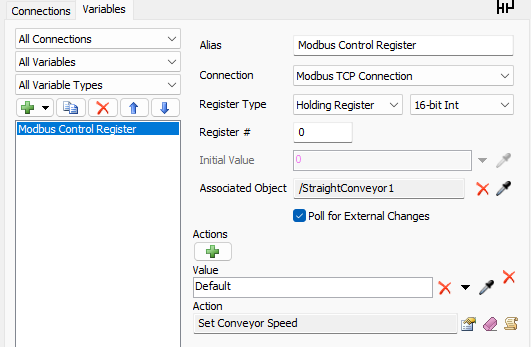

When you set up the emulation connection you can also set the conveyor speed directly without the need for an intermediate variable. (The example screenshot shows a Modbus connection but other control variables should work similarly.)
