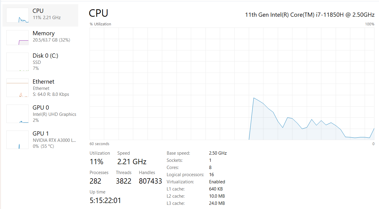

My model contains discrete and continuous objects, and I am running it for 365 days. At the end of run, when I am trying to open the window like parameters, performance measures and global table to check the results, it is not responding or there is very slow response.
Here is the screenshot of system utilization:
Any idea, why is it happening so?

Ankur A3 avatar image Ankur A3 Joerg Vogel commented ·
@Joerg Vogel
I can only see 32% memory allocation.
Could you help me to know where to check it in screenshot?
Thanks!

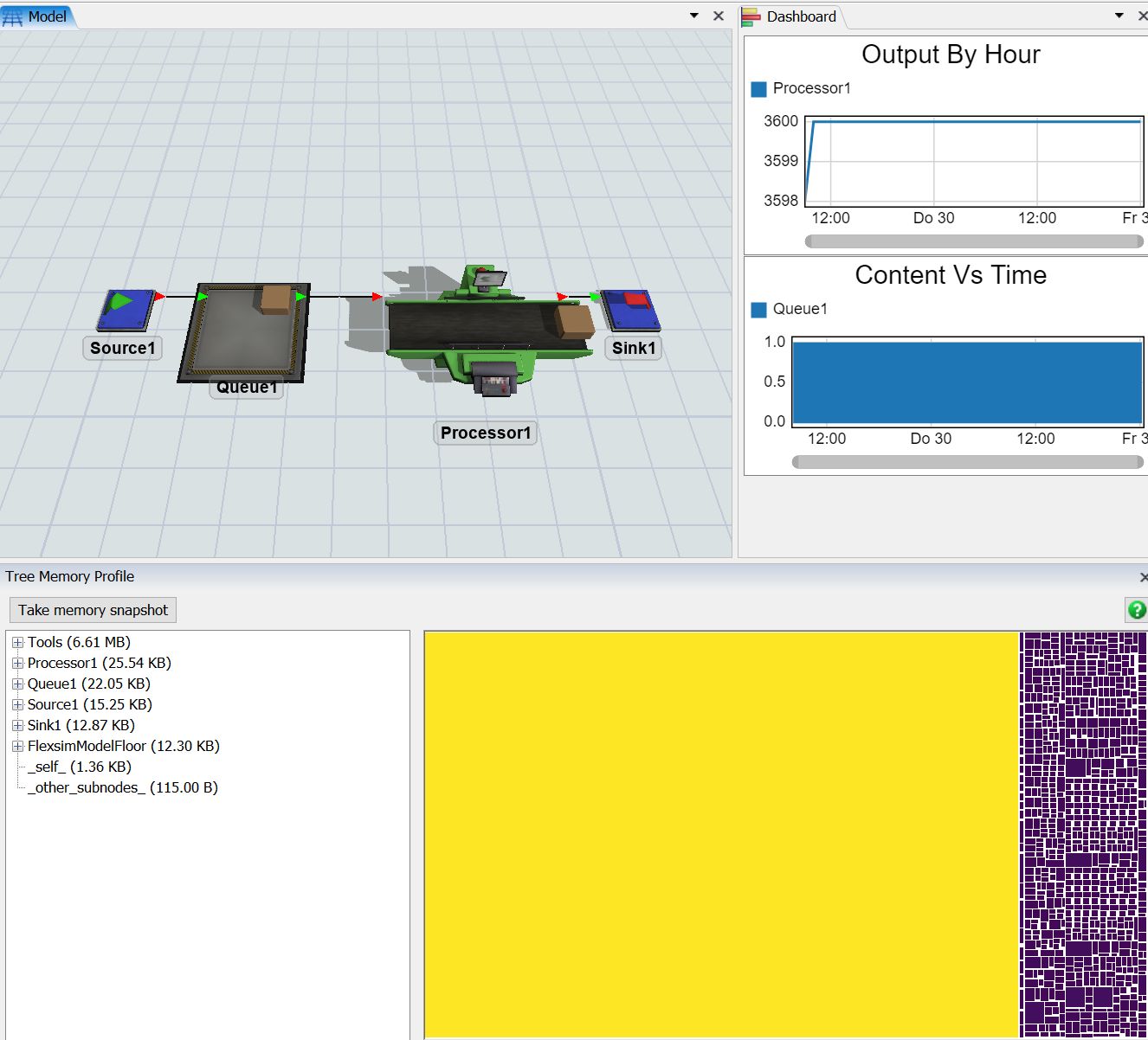

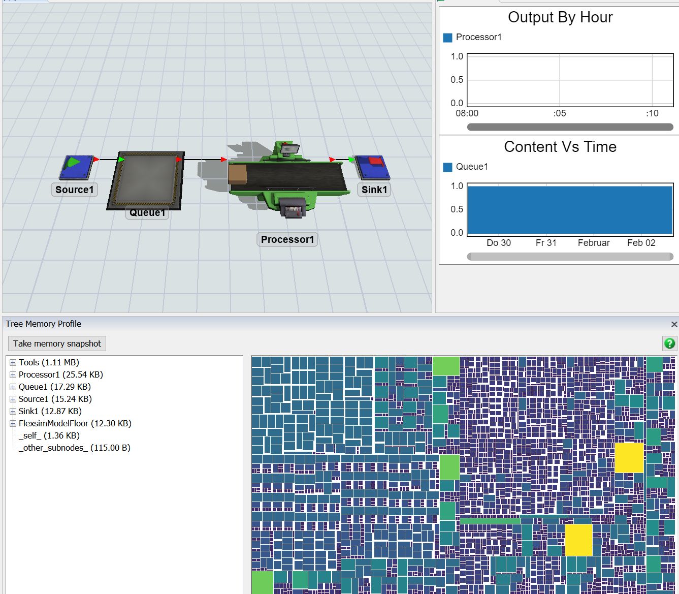

Joerg Vogel avatar image Joerg Vogel Ankur A3 commented ·
Main Menu > Debug > Memory Profiler and Performance Profiler
Near model start
A bit later
Jason Lightfoot avatar image Jason Lightfoot ♦♦ Joerg Vogel commented ·
I don't see what you're seeing Jörg.
Joerg Vogel avatar image Joerg Vogel Jason Lightfoot ♦♦ commented ·
@Jason Lightfoot, you are absolutely right about this snippet of a state. I have seen models still gathering data long after I have hit a stop button. And my attached picture are done on a machine with just 16GB memory, creating items every second runing for just a few days. You see this model ran out of memory really fast by just two statistical collectors. If a model is going into a stop, updating statistical graphs take some time. If there is not any visible change then I would check the memory allocation from within FlexSim.
