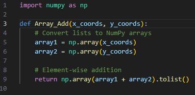

It works if the np.array is converted back into a list before returning it.1737703682260.png
