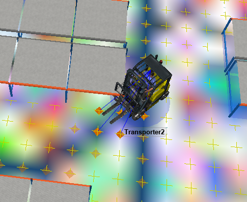

  1. When I reset and run the simulation, the floor color changes to a strange multicolor pattern, obscuring the floor layout. Please refer to the attached screenshot.

1) This seems to be an issue related to the heatmap. It happened only once for me after changing the heatmap setting, but I could not repeat this. Maybe also try deactivating and activating the option or changing the "Max Heat Value" (reset the model inbetween).
