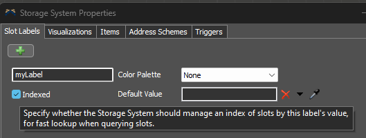

For speed accessing a large storage system by it's find and query methods, you should use one or more index on the slots and items.
Whenever you use the ORDER BY clause with a large number of returned elements you will slow things down considerably. If you want to choose a random item you might consider just getting the unordered array and selecting a random element from it (hopefully this will be implemented as an standard option in the future)
If that's still not fast enough you could use partitioned lists to reduce the number of elements in each partition and store the slot in the list.

I did notice the ORDER BY slowing the find slot down.
I will try to learn more about indexing slots and items.
