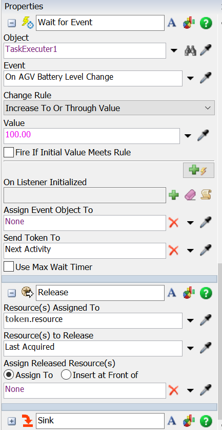

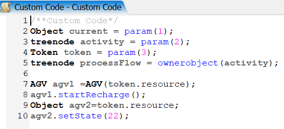

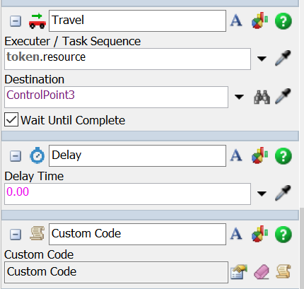

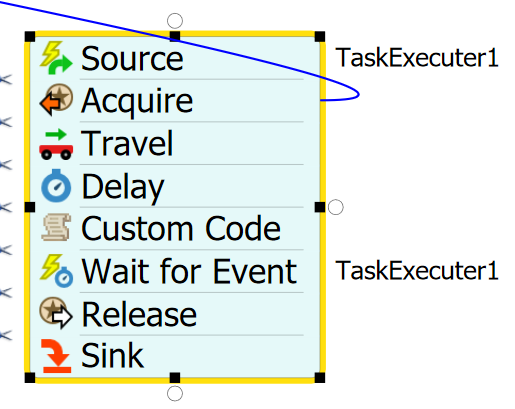

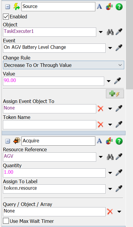

I'm currently setting AGV to go back to the charging station at 90,and keep running at 100.
But it will now go back to the charging station the first time it goes below 90, but keep working right away, and won't wait until 100.
And keep working until the power is 0.
Is my "wait for event" setting wrong?
