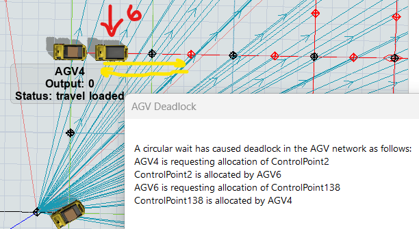

Hey Jason,
when i am running the model, at some point there is an deadlock between AGV_4 and AGV_6, because after AGV_6 drops off the item, it drives back on the bidirectional path and blocks the CP for AGV_4.
There should be a few other possible CPs to which AGV_6 could travel to, but won't.
Jason Lightfoot avatar image Jason Lightfoot ♦♦ bnh-flexsim-for-masterthesis commented ·
I can't make that happen in your original - can you post the (updated?) model ?
