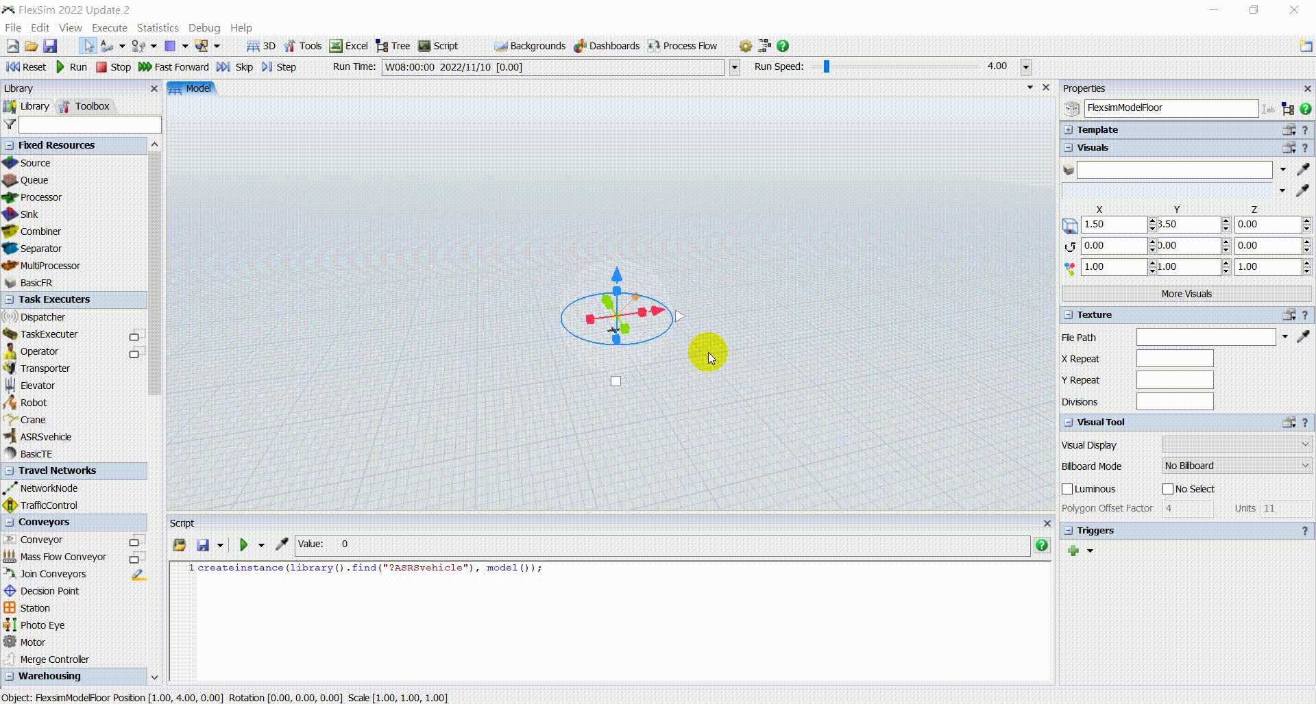

I use createinstance() to create ASRS.
However, after created and click reset, the rail location will move as the gif show.
Is it a bug or how can I modify the code?
Either add a call to firecreateevent() after creating the object
Object newObj = Object.create("ASRSvehicle"); firecreateevent(newObj, newObj.location.x, newObj.location.y, newObj.location.z, 0);
Or use dropuserlibraryobject()
dropuserlibraryobject(library().find("?ASRSvehicle"), model(), 0, 0, 0, 0, 0);
