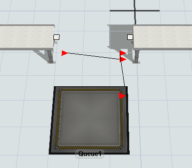

This is indeed a bug. You can get around it by first connecting the second to a different fixed resource and then draw a connection between the conveyors. Afterwards you can delete the resource you used to create the correct transfer.

Thank you Felix for your answer! Indeed I was using the same workaround that you suggested.
